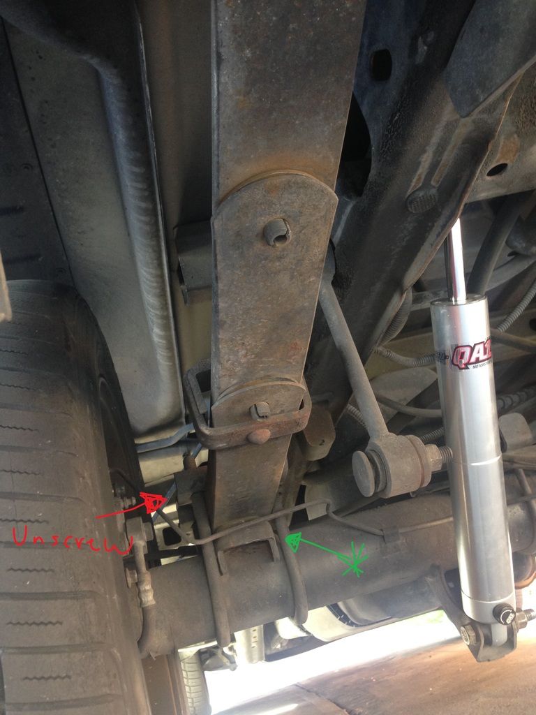

If you take this bolt off....

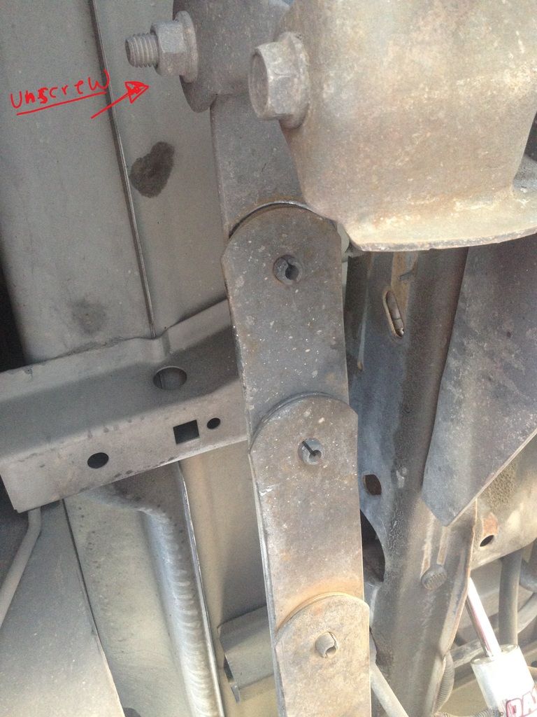

Unbolt the U-Bolts from the axle to the springs. (ill come back to the highlighted green part later.
And unscrew the far off bolt at the front of the leaf spring.

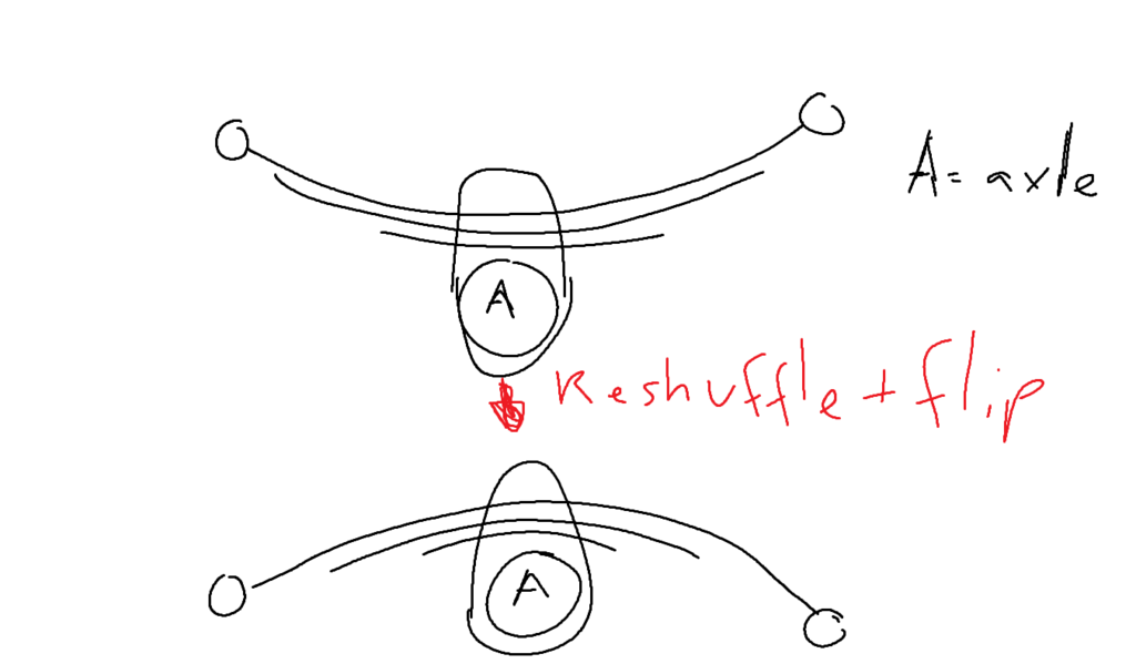

If we take the whole leaf spring and flip it over, it will be a stiff ride but it IS possible to do and will lower the truck the least an inch and a half.
To get better suspension out of the springs some have suggested to shuffle the springs for better absorption of bumps. Either way shuffled or not will work but will result in a stiffer ride.

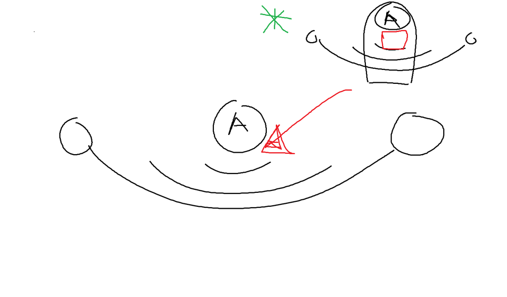

Now as far as if you would like to drop the truck more, welding would be required, if you take a look in the green arrow at the above picture #2 it shows the support for the leaf spring to sit on. You would have to weld a bottom piece to the axle to creat a support for your leaf spring if you want to transfer it under the axle like some suggested(which I never said anything about). Also you can lower it even more by adding blocks in between this way(see picture).
The result in all this is a free drop kit for yourself. Like me myself, I like to save money and would probably do this, but in the long run I don't know if it will damage my leaf springs which is why I asked if this was possible. But even then, I don't mind spending 50$ for shackles and take the safe route. Thank you everyone for your responses.

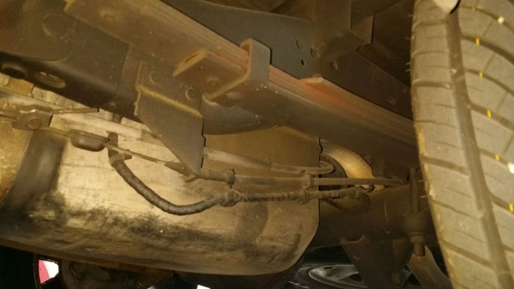

and another picture to explain why it will not work on our trucks. This shows a bed off photo of our truck. Now yes the axle in the photo is a flip kit with the axle on top of the leafs. That doesn't matter for the sake of the point I'm making here. Just look at the leaf spring itself and how it sits in respect to the frame rails in the stock position, and how it would look in respesct to the frame rails in the flipped position. You would need a MONSTER stepped notch like guys who lay frame on bags use, because you would essentially have your axle ABOVE the frame rails (whether it was on top or beneath the leaf pack).

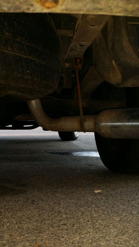

Here's a pic of the flipped spring ram. Lol
Not a half ass mod, who doesn't have time for a free mod?(if it would work) it works in some trucks SVT, i think it was a great question. And Harley answered it perfectly. I didn't think bout the axle sitting too high...oh well drop shackles it is.
That's not a flipped spring. It appears that he just pulled a leaf or 2 from the pack then combined that with Shackles and/or hangers, but that leaf pack is still in the standard mounting position. At the most he moved the overload spring from the bottom of the pack to the top. Beyond that there is nothing special about this rear drop.
