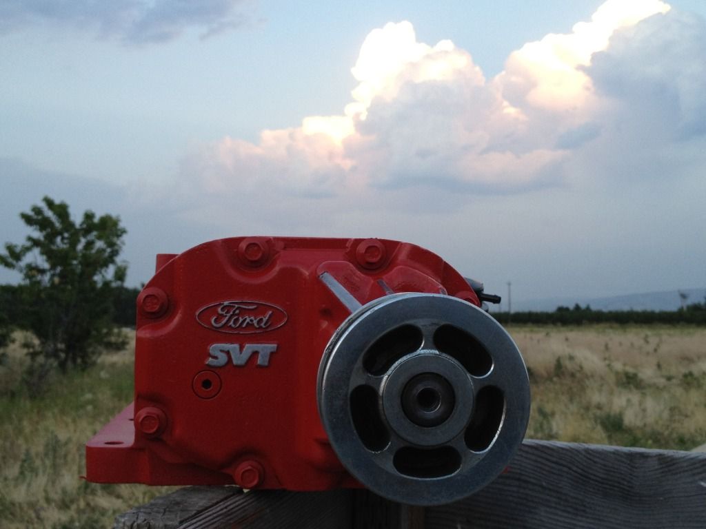

I would just use paint and not risk baking it. If you want wrinkle red, try shooting VHT wrinkle (I did mine and looks great) then maybe a few light coats of red

what happened to the VHT? Stupid question but did you shake the hell out of the can or just not what you wanted after it dried?
