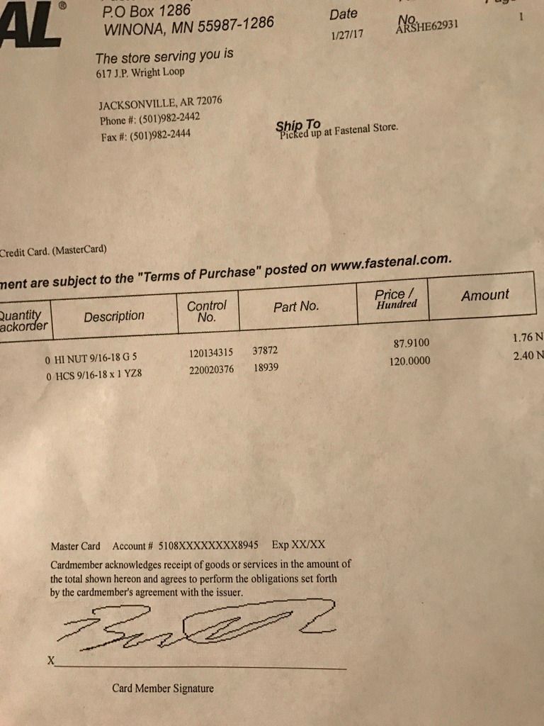

Ford Racing used to offer a “lightning-specific” bump stop kit but that’s long discontinued. It consisted of a bolt, nut, and some thread locker.
I found a member that had a spare kit tucked away and asked him to measure the nut and bolt for me. I took those measurements to Fastenal and had them special order the hardware.
All you have to do is grind or drill off your current bump stops and replace them with the nuts and bolts listed on the receipt. Some guys stack washers to make the correct height... but the nut and bolt make a cleaner, stronger bump stop.
