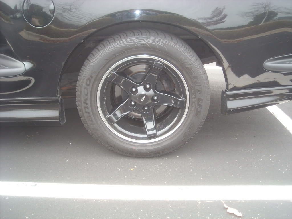

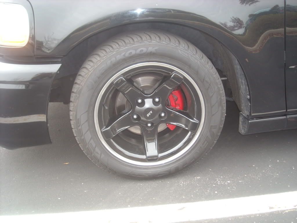

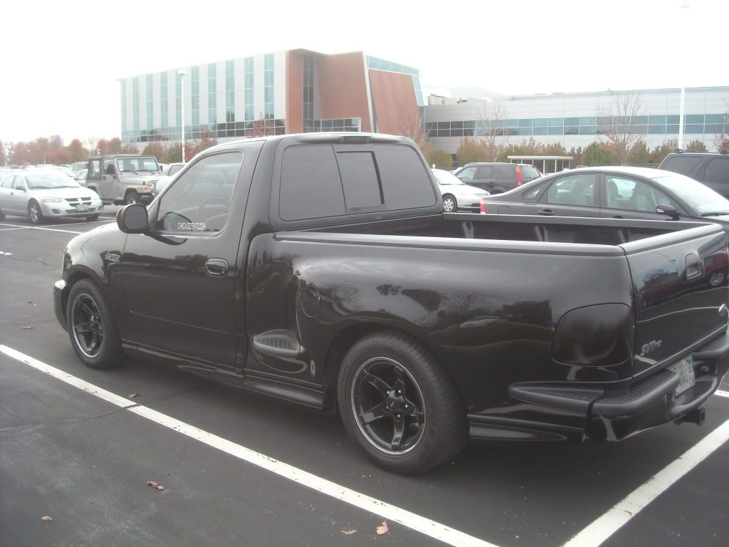

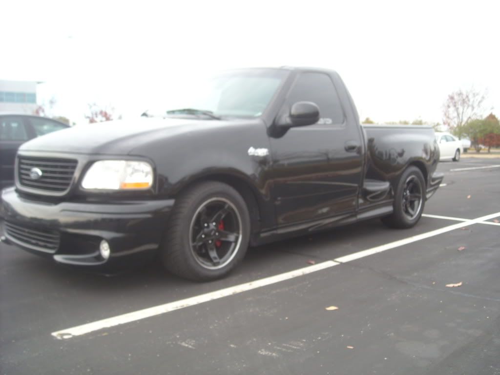

I dont want to go too low as the potholes here are terriable. Im thinking maybe a half a inch to a inch all around?
Currently Iam running
Front
Ground force lowering springs with 1 coil removed with isolator, stock spindles
Rear
2 inch drop shackles, 2 leafs removed.
aNY FEEDBACK
Forged Internals, like Roses to Men
1,104 Posts
I like the way she sits right now, but if you are looking to go lower try the JLP shackles in the rear and some Belltech 2" spindles up front.
Boostaholic
5,129 Posts
remove your isos up front and get JLP shackles for the rear and you should be set
