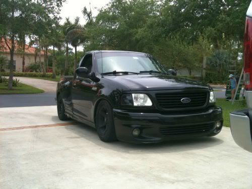

What's up guys did some work last weekend and finally got the truck aligned.
Going to raise up the front .5-1"
Drop consists of...
Front:
DJM Upper Control arms
Belltech spindles
Hotchkis springs
Bump stops removed
Isolators removed
Rear:
DJM Hangers
DJM shackles
Hotchkis leaf springs
Belltech shock extenders
Removed bump stops

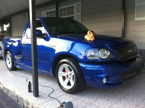

Teaser picture:potstirring
Before.
After.
My old L. The look I was going for. I think I outdid myself. :yikes

sweet low as hell!! 1" in the front would even the front and back out...1" lower and you'd be tucking tire! Are you going to notch it, or is it already?
9,499 Posts
NICE!
I say leave it as is, raising 1" in the front and you risk going baja....
Would be perfect with some chromies.. or even a medium gunmetal/smoke/charcoal color wheel. or black rims but don't tell stoffer
FLRC
1,744 Posts
Looks great but going over speed bumps will be hell though..

Thanks for the comments guys! I would never go any lower than it's sitting right now. When I am driving on the highway and hit big dips she scrapes frame in the front.
I had to remove my ds safety loop. It was grinding the drive shaft. Caught it before anything happened.
I do not have a c-notch yet but we did cut away the little lip from the frame to allow the axle room. Big bumps it will slap frame... I will notch it when the money is available.
Chris(1sweetsvt) and myself did all the work last Sunday. It's a pretty big job to take on in one day. Not to mention their is always little hiccups that set you back lol.
The abandoner
3,532 Posts
LOL little hiccups.....good advice to all, dont do suspension work on a truck thats spent its life up north in the snow and salt without air tools
more pics to come this weekend....
