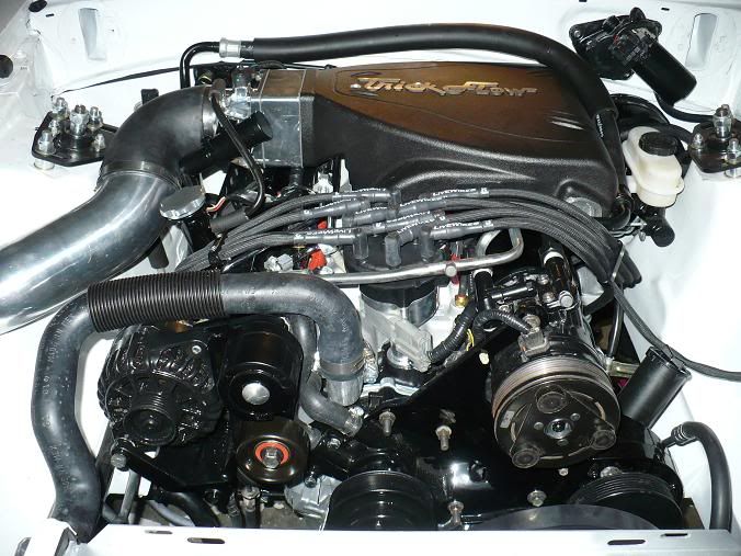

It's been a long road. I pulled the engine on January 26th. The day I've been waiting for is tomorrow.
Going to get my 87 Mustang GT vert dyno tuned tomorrow. What's everyone guess on power?
Here's the specs on the motor.
347 10.2-1 compression
Roller 302 Block
Scat Cast Steel 3.400 Crankshaft
Scat Forged Steel I Beam Connecting Rods 5.400
Probe SRS 2618 Forged Pistons (Flat, TFS) 4.030
FordStrokers Custom HYD Roller Camshaft
Intake Exhaust
Adv Duration 274 286
Duration @ .050 224 237
Lobe Lift 0.359 0.354
Rocker Ratio 1.6 1.6
Gross Lift 0.574 0.566
Lobe Centerline 110 114
Open @ .050 2 BTDC 52.5 BBDC
Close @ .050 42 ABDC 4.5 ATDC
LSA 112
TFS Twisted Wedge Fast as Cast 190cc Cylinder Heads
Comp Cams Ultra Gold Rocker Arms 1.6
30lb injectors
Trick flow track heat intake
Anderson 4" power pipe
Pmas 80mm MAF
1 3/4 BBK long tubes
offroad h pipe 2 1/2"
Dynomax cat back 2 1/2"
373 gears
T5 trans
Video & dynoi sheet to follow.
