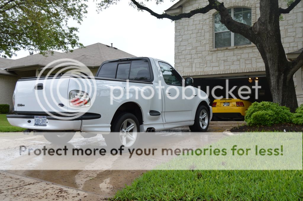

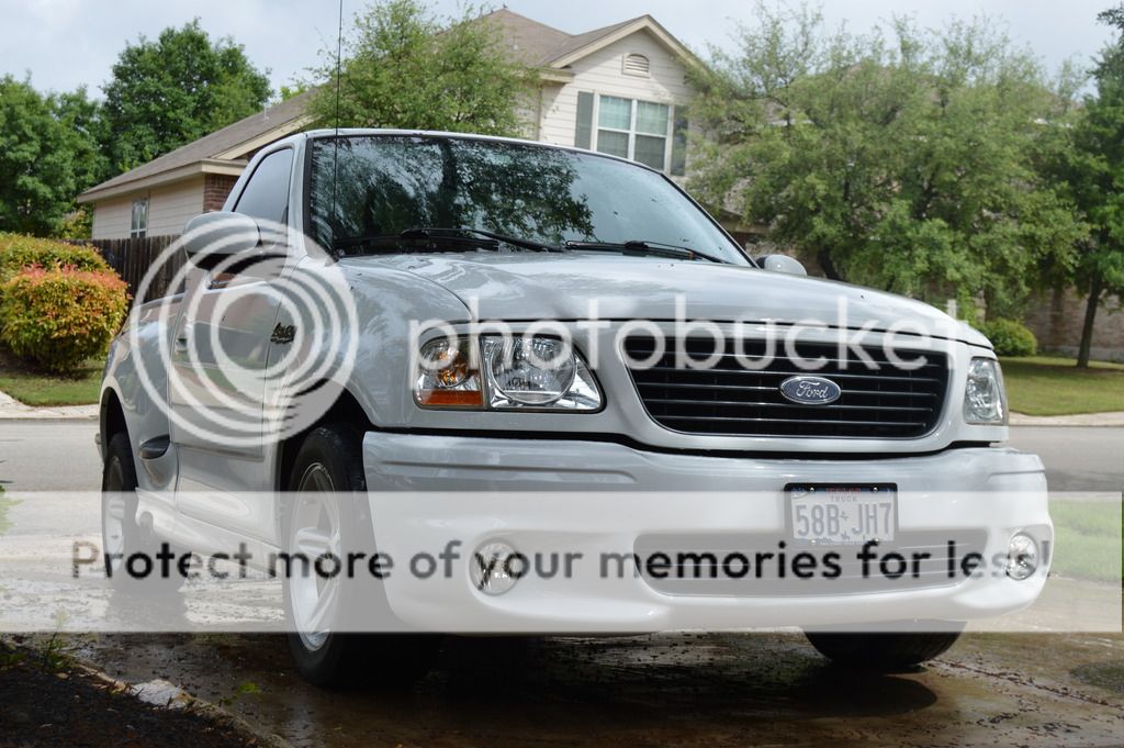

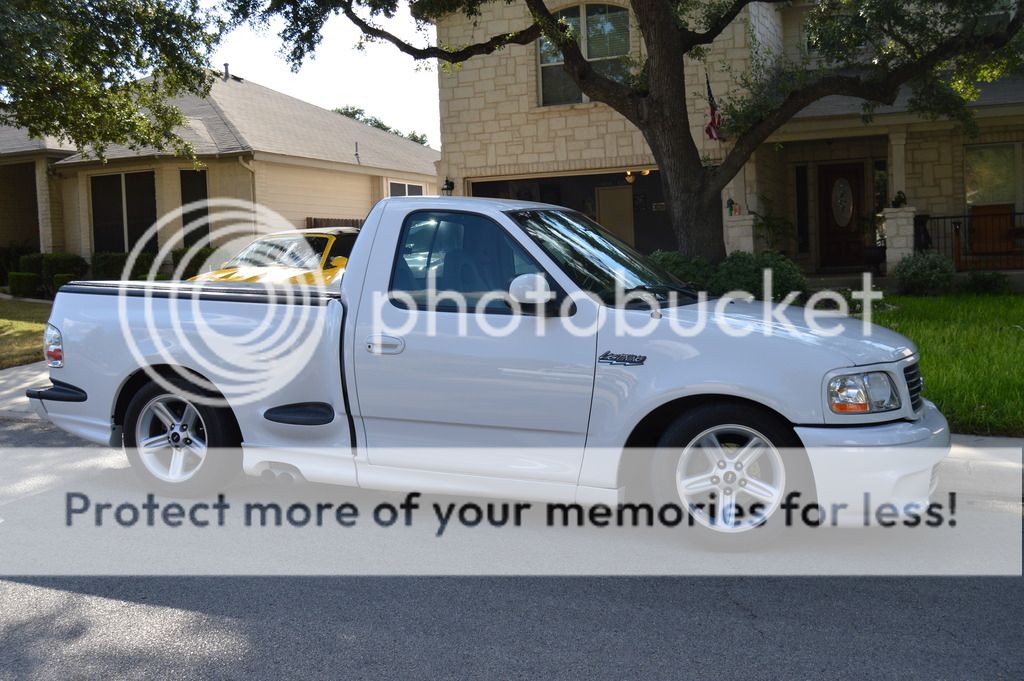

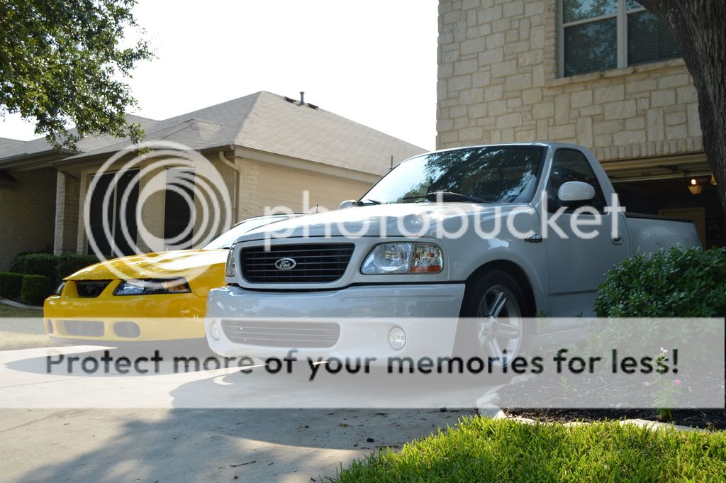

So I dropped the L couple weeks ago (used BellTech Springs, Shackles, Hangers 2/4), when I go over 50 you can feel a slight vibration. It feels like the tires need to be rebalanced and its annoying, it has to be due to the drop. The truck has 40k miles and when it was at stock height it felt and drove like new.
I was talking to another L owner and he said I need to adjust the driveshaft or the pinion angle? This is my first F150 and I just want to have an idea of what Im supposed to be looking for or asking a mechanic to do - thanks!

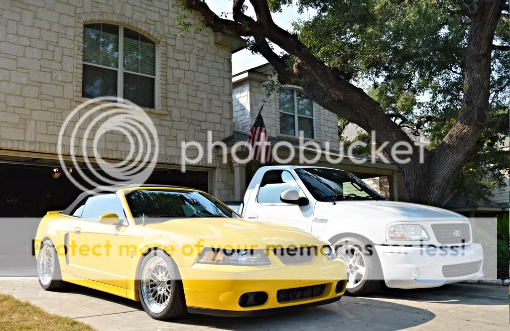

Pics of before and after:

Looks great.

Agreed for the pinion angle adjustment. Need to get some shims to correct that. When I got mine done it came with the shims. Mine is a Belltech drop as well. You can buy the shims and put them on or take your truck to a driveline shop and have them balance the driveshaft(recomended) and set the proper pinion angle while its there. Truck does look awesome. Especially next to the mustang:smt023

And thanks for the compliments, sadly the Terminator was sold about a week and 1/2 ago. I picked up an PP Premium S550 to replace her tho :)

NICE matching white beauties!! You are a lucky man. I think someone mentioned a 2* for street. That sounds about right. But to really know you should check it with a protractor and string. Or if you have a smart phone you can use this app,... Its called Tremec, like the transmission. You then can use your phone to figure it out.:smt023
