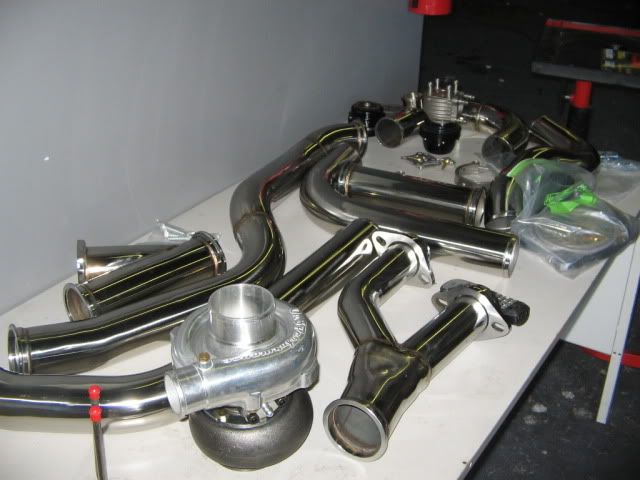

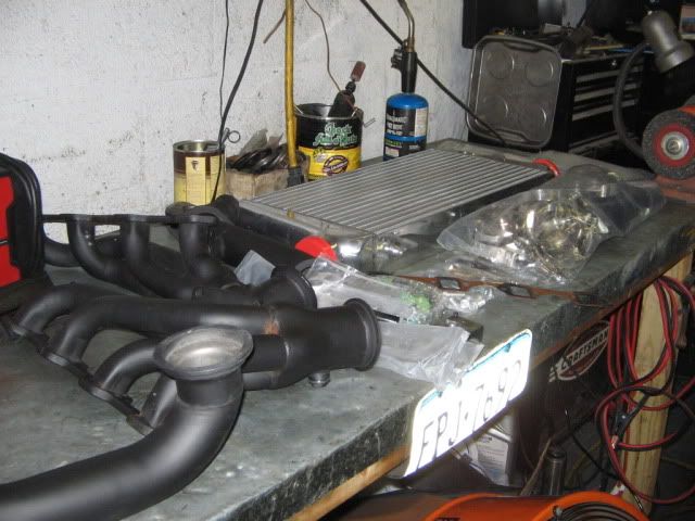

Christian's 1992 Foxbody Hatch was dropped off and we started disassembly today for the turbo kit install. We will be utilizing a 67MM BB Turbocharger and a minimal amount of boost considering she's still on a stock block. Baseline dyno she put down 275/290 w/ GT40 Heads, Trick Flow intake, and shorty headers w/ off road exhaust.

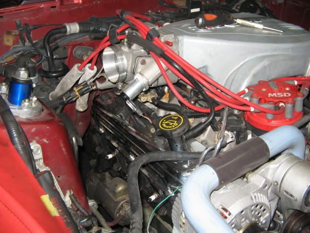

We had to make some mild modifications to the inlet pipe to the throttle body as the bend was off typical of the On3Performance kits, but all in all the fit was good.
Should be finished up tomorrow with the kit then have some electronics and a few other things to do. Got a few boxes of goodies for some other jobs we were waiting on today so we'll be getting back into those tomorrow as well.
